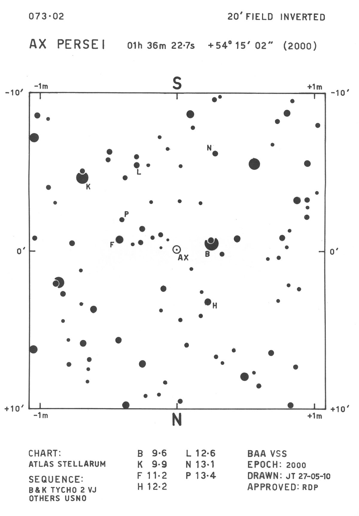

First you need to identify the star. For large-amplitude variable stars from the list it's better to search for comparison stars or neighborhood layout, since the target variable star's brightness may be beyond (fainter) your device limit, thus never be found. For most of the stars listed below you don't need to observe them each night. Often it is quite enough to measure the light once a week. This is possible due to a large period of variabilty. You can find this information in the tables. Also you have to remember that visual observing of red stars are tricky: for human's eye it may be difficult to measure the light from red variables reliably. Comparison stars should be selected carefully in this case as well. De-focusing technique may be applied to the variable and comparison stars to make your magnitude estimate more precise.
