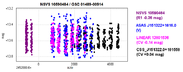

Figure 1. - Light curve of NSVS 10590484 (GSC 01489-00914), based on data from various sky surveys as indicated in the legend on the right side. In order to facilitate period analyses, NSVS, LINEAR and CSS data have been shifted by the indicated amounts to match ASAS-3 V data.

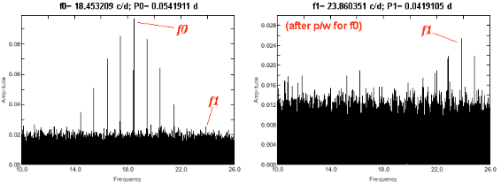

During an investigation of the pulsational behaviour of HADS stars, we have analyzed available data from the NSVS (Woźniak et al., 2004), ASAS-3 (Pojmański, 2002), LINEAR (Stokes et al., 2000) and CSS (Drake et al., 2009) databases for NSVS 10590484 using Period04 (Lenz and Breger, 2005). In addition to confirming the period determined by Ditkovsky, we were able to identify an additional peak in the power spectrum of NSVS 10590484 at a frequency of 23.860351 cycles per day which corresponds to a period of P= 0.0419105 days (cf. Figure 3). While this signal is of low amplitude, the derived signal-to-noise ratio of 6.3 – calculated using Period04 – indicates a significant detection. Furthermore, the period ratio of P1 / P0= 0.7734 is indicative of radial pulsation and unmasks the additional period as the first overtone mode. We are thus confident of the reality of the detected additional frequency.

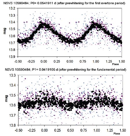

Figure 2. - Phase plots of NSVS 10590484 (GSC 01489-00914), illustrating the fundamental and first overtone modes. Data and colours are the same as in Figure 1.

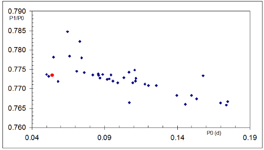

The light curve of NSVS 10590484 is given in Figure 1. Phase plots illustrating the fundamental and first overtone periods are shown in Figure 2. A Petersen diagram – a diagram plotting the period ratios versus the fundamental mode periods – is often used to study double-mode radial pulsating stars (cf. e.g. Poretti et al., 2005). We present a Petersen diagram of a sample of well known Galactic double-mode HADS stars and NSVS 10590484 in Figure 4. The location of NSVS 10590484 in this diagram is consistent with that of other Galactic HADS(B) stars.
Figure 3. - Power spectra of NSVS 10590484 (GSC 01489-00914) for the combined dataset as specified in Figure 1 (left side) and after substraction of the fundmental mode frequency (right side).
Figure 4. - Petersen diagram for a sample of well-known Galactic double-mode HADS stars with period ratios in the range between 0.76 and 0.79 (blue diamonds; N= 38) and NSVS 10590484 (red circle). Data were taken from the VSX.
